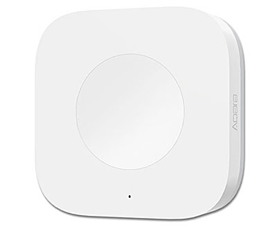

Aqara Smart Wireless Switch US $18.29

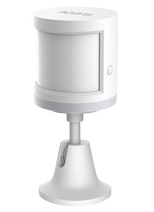

Aqara Human Body Sensor US $16.39
